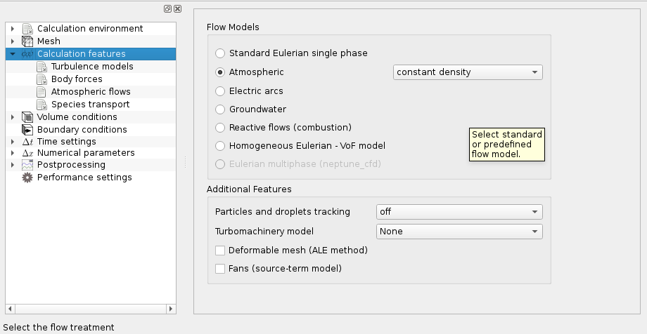

The GUI may be used to enable the atmospheric flow module and set up the following calculation parameters in the Thermophysical models - Calculation features page see fig:steady.
The user can choose one of the following atmospheric flow models:
The specific heat value has to be set to the atmospheric value
