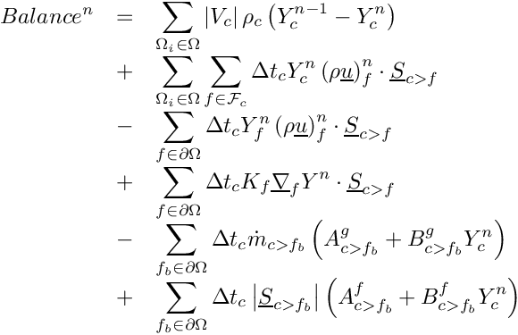

The balance at time step n over a subdomain $ \Omega $ of boundary $ \partial \Omega $ is equal to:
\begin{array}{r c l}
Balance^n &=& \displaystyle
              \sum_{\Omega_i \in \Omega}
                \norm{\vol{\celli}} \rho_\celli
                \left(\varia_\celli^{n-1} -\varia_\celli^n \right)  \\
         &+& \displaystyle
             \sum_{\face \in \Face{\celli}}
                \Delta t_\celli
                \varia_\celli^n \left(\rho \vect{u}\right)_\face^n \cdot \vect{S}_{\iface} \\
         &-& \displaystyle
             \sum_{\face \in \partial \Omega}
                \Delta t_\celli
                \varia_\face^n \left(\rho \vect{u}\right)_\face^n \cdot \vect{S}_{\iface} \\
         &+& \displaystyle
                 \Delta t_\celli
                 K_\face \grad_\face \varia^n \cdot \vect{S}_{\iface} \\
         &-& \displaystyle
             \sum_{\fib \in \partial \Omega}
                \Delta t_\celli \dot{m}_\ib
                \left(A_\ib^g + B_\ib^g \varia_\celli^n \right) \\
         &+& \displaystyle
                \Delta t_\celli \norm{\vect{S}_\ib}
                \left(A_\ib^f + B_\ib^f \varia_\celli^n \right)
\end{array}
The first term is negative if the amount of scalar in the volume has increased (it is 0 in a steady regime).
The terms of convection and diffusion (at internal or boundary faces) are positive if the amount of scalar in the volume has increased.
In a steady regime, a positive balance thus indicates a scalar gain.
