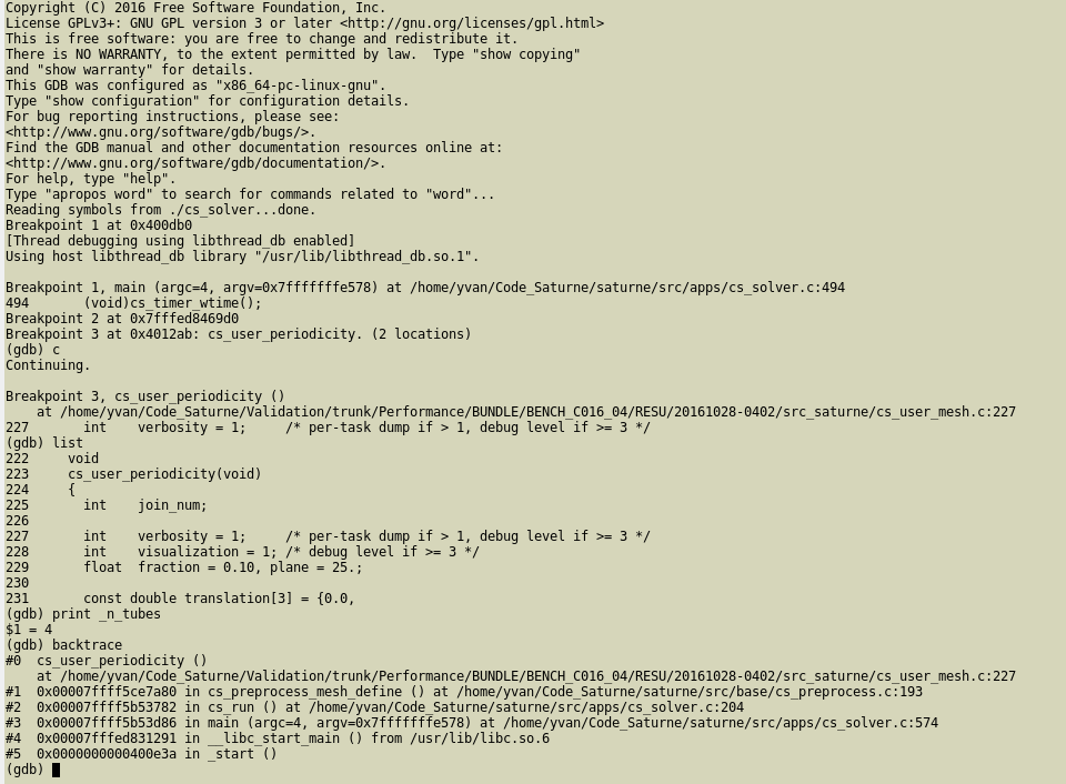

The GNU debugger
The GNU debugger https://www.gnu.org/software/gdb is a broadly available, interactive debugger for compiled languages including C, C++, and Fortran.
  • To debug an executable, run gdb <executable>
    • Under the gdb prompt, type help for built-in help, q to quit.
    • Help is grouped in categories
      • The most common options are:
        • b (set breakpoint),
        • c (continue to next statement),
        • s (step into function),
        • p (print).

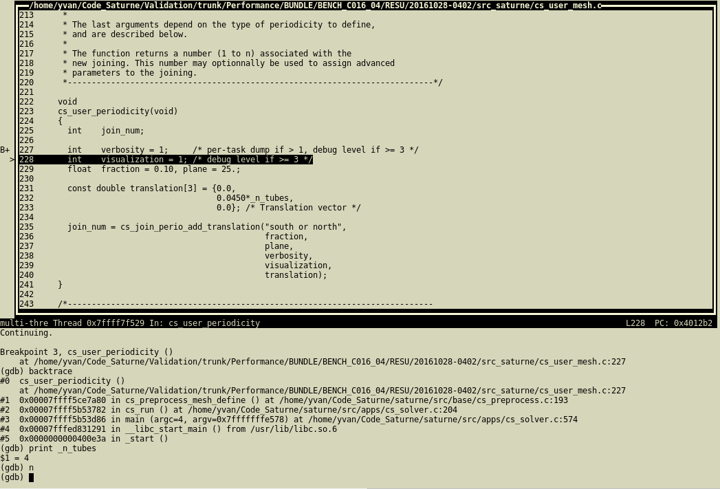

When used directly, GDB runs in a single terminal frame, as shown here. Only the current line of code is shown, though the list command allows showing more.
GDB in terminal mode
When started with the -tui option, GDB runs in a split terminal, with source on top, commands on bottom.
  • Using the CTRL+x+o key combination allows changing focus from one to the other.
  • Using the CTRL+l key allows refreshing the display.
GDB with split screen

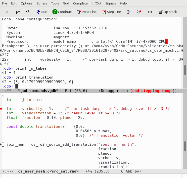

GDB may also be run under Emacs, which provides syntax highlighting of source code.
GDB under Emacs
GDB base commands
Checking the gdb documentation or tutorials is recommended. The most important gdb command is:
help
The most commonly used commands are:
  • b: set a breakpoint.
  • c: continue.
  • p: print a variable's value (using the current programming language syntax).
  • up: move up the stack.
  • down: move down the stack.
A running program may be paused using CTRL+C.
Variables may not only be printed, but also modified interactively, and functions may be called, making it easy to test some hypothesis without restarting the whole program.

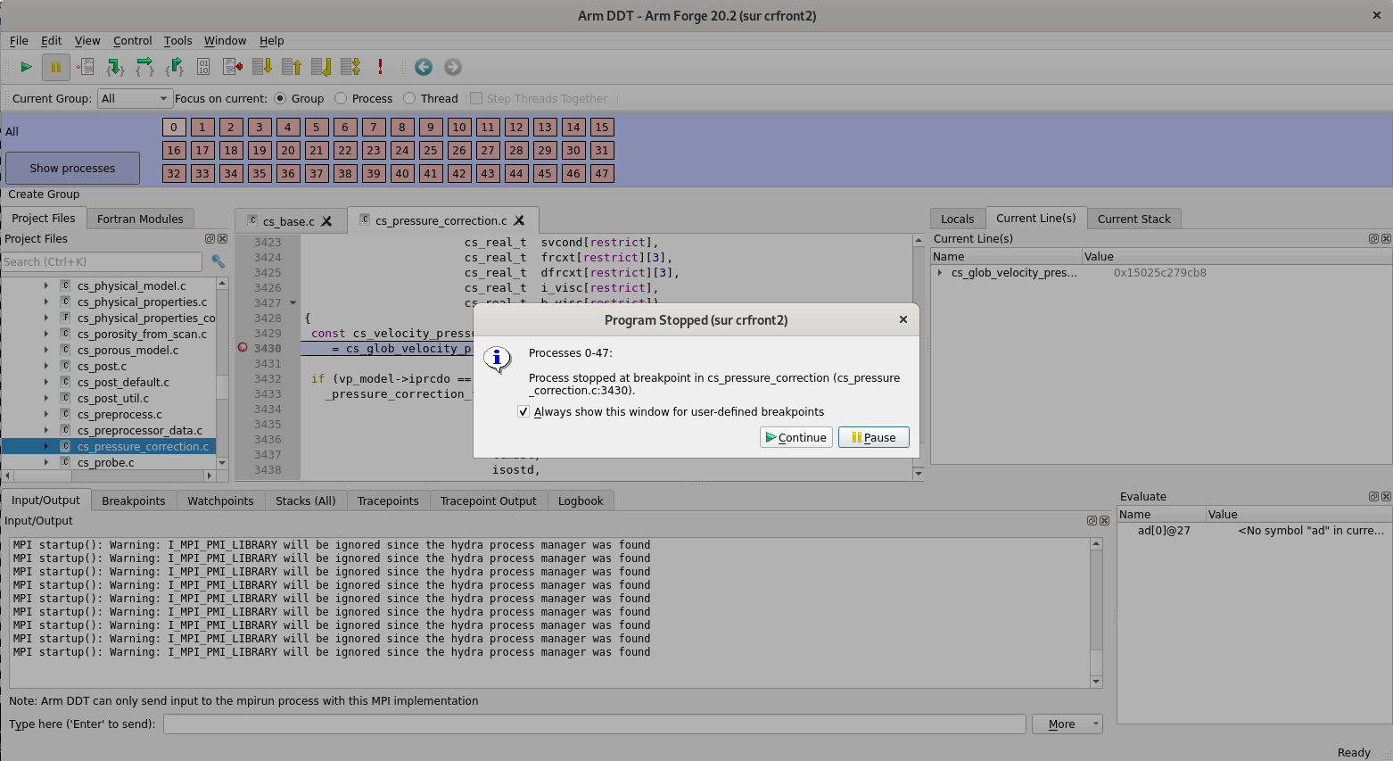

Graphical front-end recommendations
Many graphical front-ends are available for gdb. When evaluating a front-end, we recommend to check for the following features:
  • Must provide a console to allow combining text-based commands with the graphical elements, or at least easily-accessible widgets in which watchpoints and expressions to print can be typed.
  • Should allow some means (such as command-line options) to connect to a GDB server through a socket interface (more on this later)
The DDD (Data Display Debugger) front-end is obsolete and uses a dated graphical toolkit, but has the advantage of combining a command prompt with graphical tools, and is very easy to use, so it might remain an option.

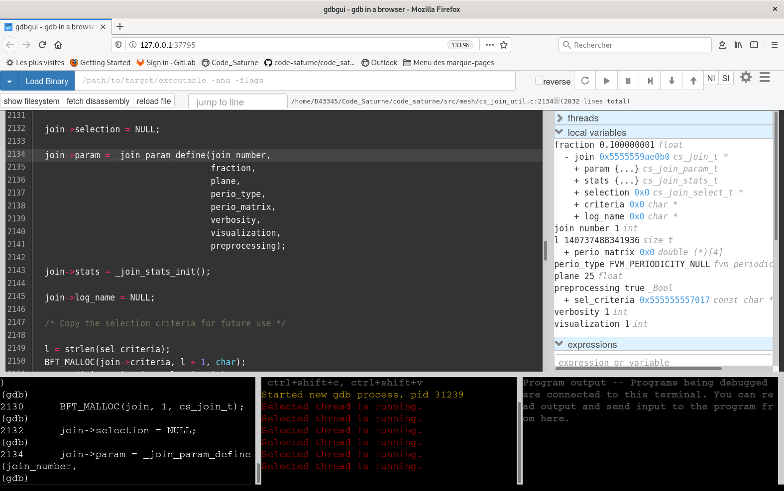

The gdbgui debugger seems promising, and a good potential successor to DDD. It is based on a web-browser interface,
gdbgui

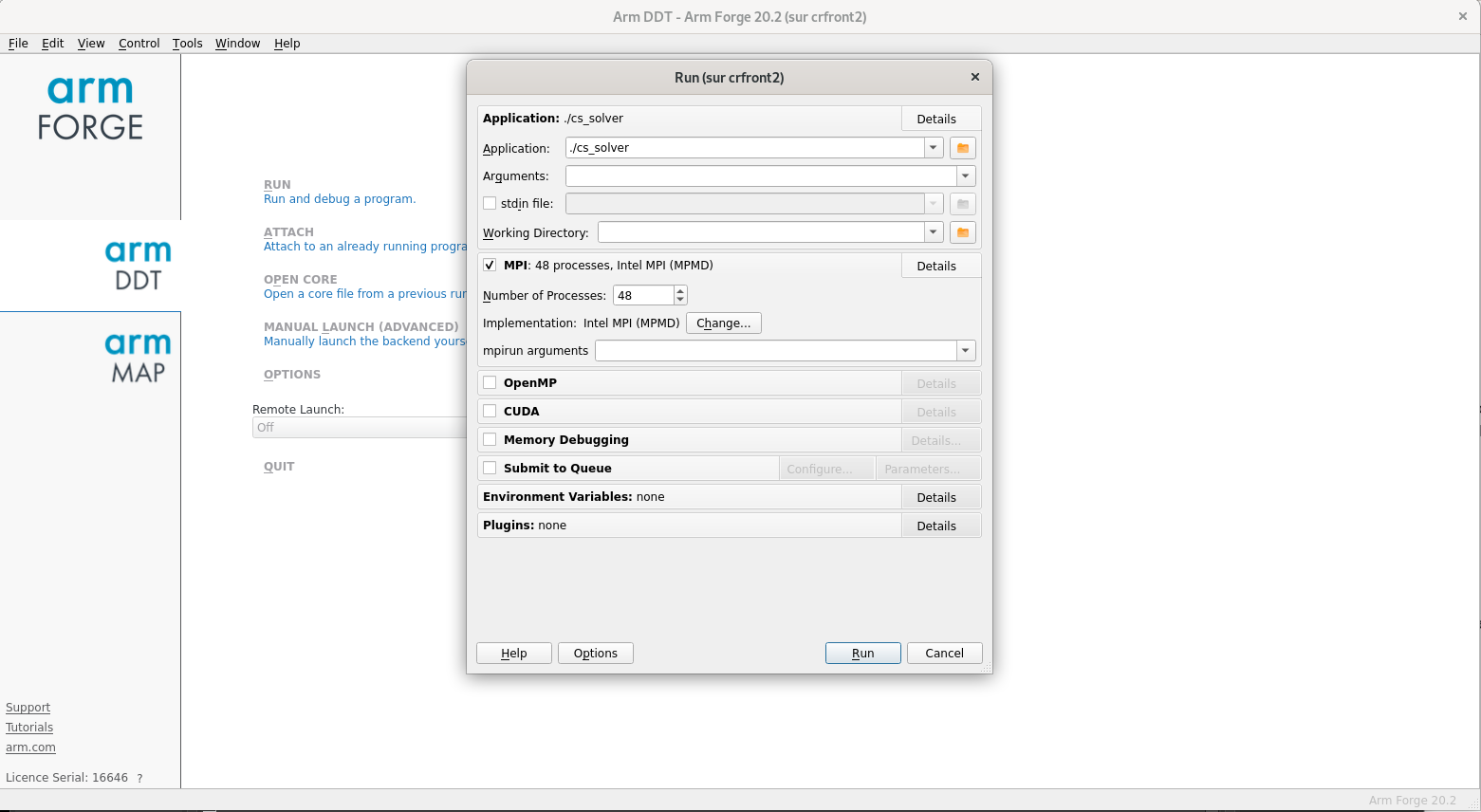

Full integrated development environments (including Qt Creator, Visual Studio Code, Eclipse, Kdevelop, Anjuta) are outside the scope of this documentation. Most members of the code_saturne development team mostly use lighter, less integrated tools, so will not be able to provide recommendations regarding their use.

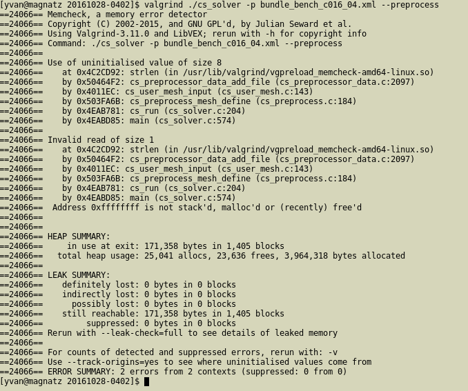

The Valgrind tool suite
The Valgrind tool suite allows the detection of many memory management (and other) bugs.
  • Dynamic instrumentation
    • No need for recompilation
      • Usable with any binary, but provides more info (i.e. code line numbers) with code compiled in debug mode
      • Depending on tool used, run time and memory overhead from 10-100x.
        • With default tool (Memcheck), 10x30.
        • Use proactively, to detect bugs on small cases, before they become a problem in production cases.
Valgrind is easy to run:
  • Prefix a standard command with valgrind
    • By default, uses the memcheck tool.
    • Tool may be changed using valgrind –tool=/cachegrind/callgrind/drd/massif/...
  • Valgrind may be combined with GDB using its gdbserver mode.
    • To use this mode, call valgrind –vgdb-error=<number>
      • The number represents the number of errors after which the gdbserver is invoked (0 to start immediately).
Valgrind in a terminal

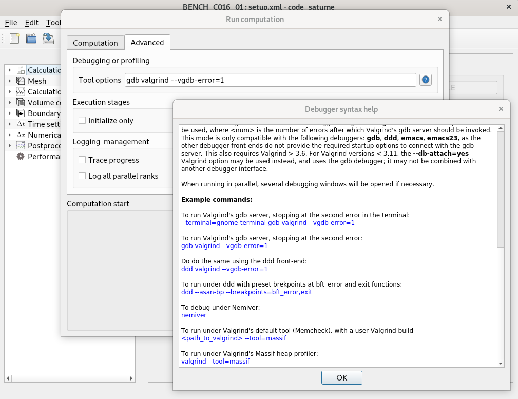

Starting the code_saturne solver under a debugger
Several ways of setting code_saturne to run under a debugger are possible:
  • Using the GUI, set options in Run computation/Advanced options`
    • The associated help provides several examples
    • This sets a debug_args option under the current resources section in the case's run.cfg file, which can also be edited directly.
  • The same options can be provided directly to code_saturne run using the --debug-args option
Example of use of debugger wrapper
When the code is run, the debugger will then be launched automatically.
Arguments required by the debug wrapper
To run the execution under a debugger, a string with the following syntax structure should be used:
<debugger> [debugger_options] [valgrind [[valgrind_options]]
Or, for Valgrind only:
<valgrind> [valgrind options]
where < > denote required arguments, and [ ] optional arguments.
The following debuggers and user interfaces are handled: gdb (GNU Debugger), cuda-gdb, cgdb (console-front-end to gdb), gdbgui (browser-based frontend to gdb), ddd (Data Display Debugger), emacs (as gdb front-end), kdbg (KDbg), kdevelop (KDE developement environment), gede (simple Qt-based gdb GUI), nemiver (GNOME Nemiver debugger), valgrind (Valgrind tools for memory debugging).
If a debugger may not be found in the PATH, an absolute path should be given instead.
The following debug wrapper options are handled:
--asan-bp adds a breakpoint for gcc's Address-Sanitizer
--back-end=gdb path to debugger back-end (for graphical front-ends)
--breakpoints=LIST comma-separated list of breakpoints to insert
--ranks=LIST comma-separated list of MPI ranks to debug
--terminal terminal type to use for console debugger
Other, standard options specific to each debugger may also be used, as long as they do not conflict with options in this wrapper
To combine a Valgrind tool with another debugger, Valgrind's --vgdb-error=<num> option should be used, where <num> is the number of errors after which Valgrind's gdb server should be invoked. This mode is only compatible with the following debuggers: gdb, gdbgui, ddd, emacs, as the other debugger front-ends do not provide the required startup options to connect with the gdb server.
Note that compared to a standalone use of the gdb debugger, running under the debug wrapper automatically sets breakpoints at program start and end and launch the program.
To define commands such as setting breakpoints, a small gdb script with the .gdb extension is generated for each rank. It can be removed safely after program start.
When running in parallel, several debugging windows will be opened if necessary.

Running under Vim or Neovim
The code_saturne debug wrapper does not yet support launching GDB under Vim or Neovim.
Various examples of use of debugging with Vim are found on the web, explaining how Termdebug for example can be used.
Support for these tools could be added if users can provide a command-line example for launching a debugging session with their favorite editor and help test this.

Debugging parallel code_saturne runs is not very different from debugging serial runs, though stepping through a program may be more cumbersome unless a parallel debugger is used.
Using a parallel debugger
If a true parallel debugger such as TotalView or Arm is available, the following procedure may be used:
  • First, initialize the execution directory, using one of the following methods:
    • From the GUI, in the advanced run/job submission options, check "initialize only", then submit the computation.
    • Outside the GUI, run code_saturne submit --initialize In either case, the code will prepare the execution directory, and preprocess the mesh if needed, but not remove the executable and temporary script.:
  • Once the stage has finished, cd to the execution directory, and edit the run_solver script script:
    • Add commands necessary to load the debugger's environment. For example, on the EDF Cronos cluster, this requires adding
      module load arm-forge
      in the section where other modules are added.
    • Search for the line actually launching the solver, near the end of the script; before the cs_solver command, insert the debugger command. For example, for the DDT debugger, replace
      mpiexec <options> ./cs_solver
      with:
      mpiexec ddt <options> ./cs_solver
  • If using a batch system, request an interactive allocation (for example, using salloc with SLURM). ** This step is important: without this, you may be trying to run a large job on a front-end node, and your cluster administrators will not be happy.**
  • You can then run:
    ./run_solver
    which will launch the code under the interactive debugger.
Debuggers such as DDT allows to easily switch between global and local stepping through the program and exploring its data, using a single window, as illustrated in this screenshot:
Global DDT pause
Remarks:
  • On some clusters using srun as the configured mpiexec command, the srun command configuration may not be compatible with DDT. In this case, switch to another appropriate mpiexec command.
  • In case launching the debugger fails, an alternative option is to simply replace the whole launch command (the line containing cs_solver) with the command launching the debugger's GUI, for example
    ddt
    And then simply follow the debugger prompts for command launch options, as shown in the example below.
    Example DDT launch options
