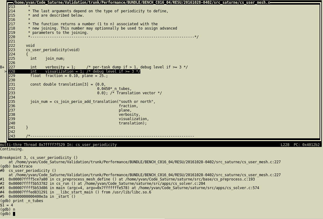

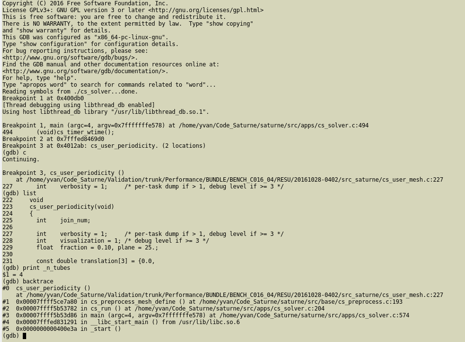

configure option at installation.When used directly, GDB runs in a single terminal frame, as shown here. Only the current line of code is shown, though the list
command allows showing more.
When started with the -tui
option, GDB runs in a split terminal, with source on top, commands on bottom.
CTRL+x+o
key combination allows changing focus from one to the other.CTRL+l

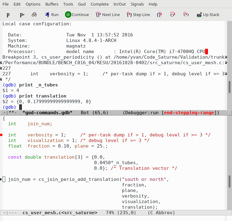

key allows refreshing the display.GDB may also be run under Emacs, which provides syntax highlighting of source code.

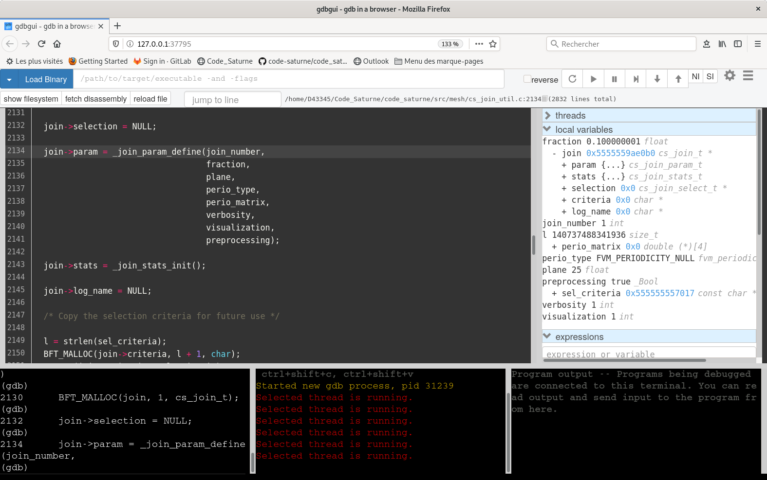

The gdbgui debugger seems promising, and a good potential successor to DDD. It is based on a web-browser interface,

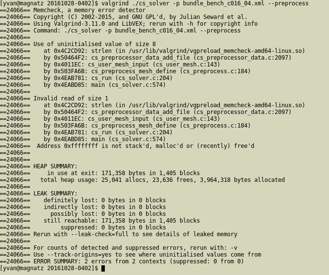

The Valgrind tool suite allows the detection of many memory management (and other) bugs.
Valgrind is easy to run:

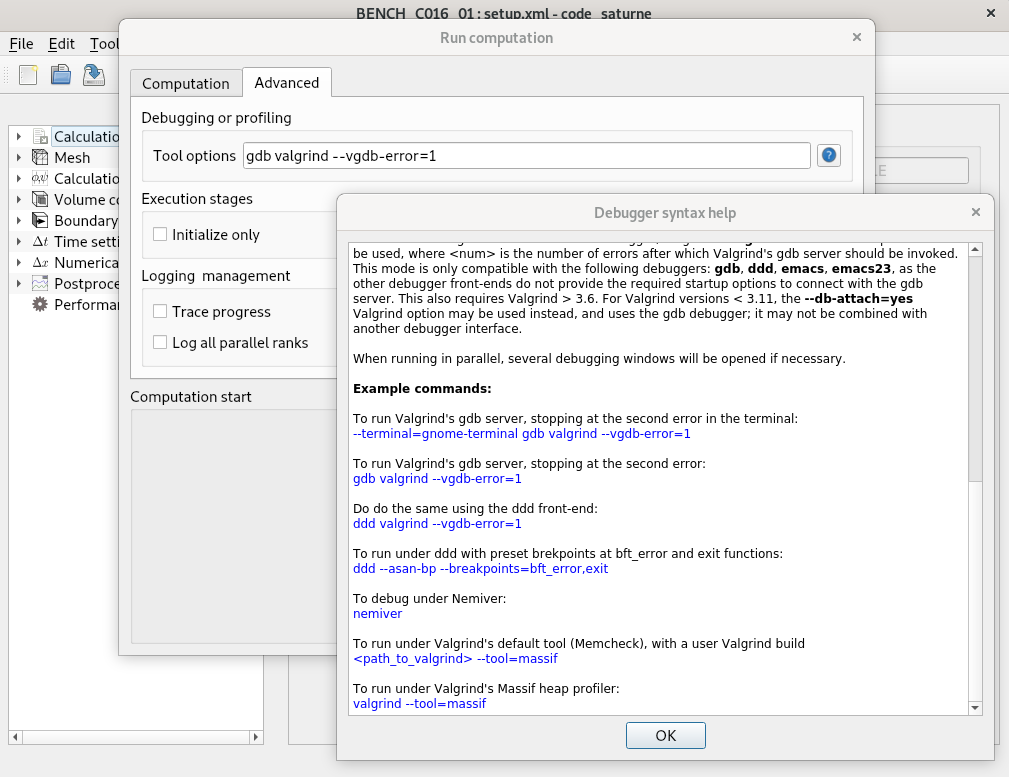

To combine a Valgrind tool with another debugger, Valgrind's --vgdb-error=<num>
option should be used, where <num>
is the number of errors after which Valgrind's gdb server should be invoked. This mode is only compatible with the following debuggers: gdb, gdbgui, ddd, emacs, as the other debugger front-ends do not provide the required startup options to connect with the gdb server.

To simply run using the gdb debugger:
To run Valgrind's gdb server, stopping at the second error in the terminal:
To run Valgrind's gdb server, stopping at the second error:
Do do the same using the ddd front-end:
To run under gdb with preset brekpoints at bft_error and exit functions:
To debug under gdbgui:
To run under Valgrind's default tool (Memcheck), with a user Valgrind build
To run under Valgrind's Massif heap profiler:

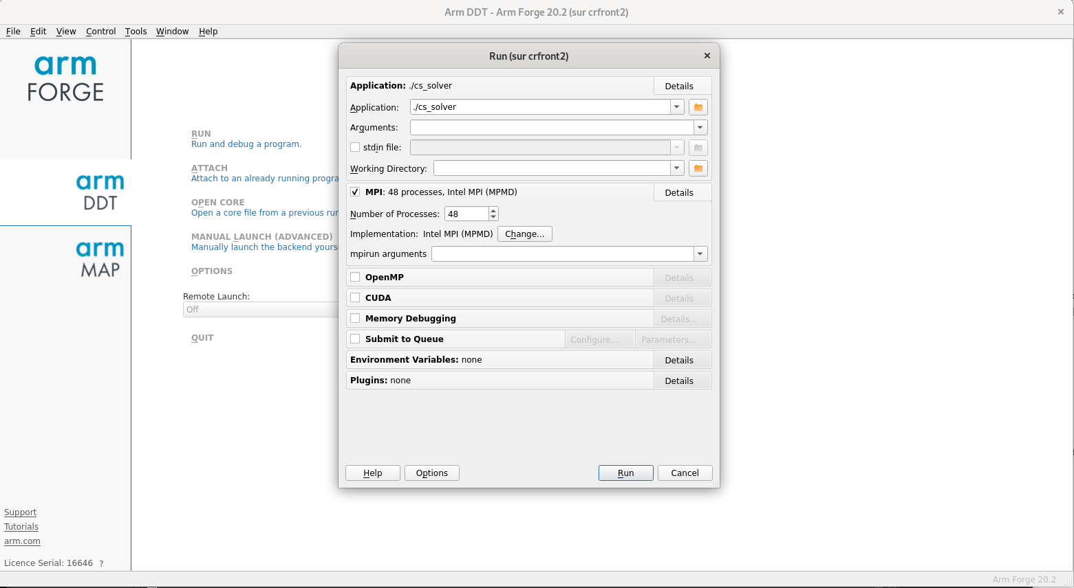

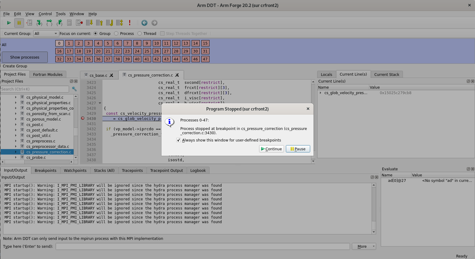

Debugging parallel code_saturne runs is not very different from debugging serial runs, though stepping through a program may be more cumbersome unless a parallel debugger is used.
If a true parallel debugger such as TotalView or Arm is available, the following procedure may be used:
code_saturne submit --initialize
In either case, the code will prepare the execution directory, and preprocess the mesh if needed, but not remove the executable and temporary script.:cd
to the execution directory, and edit the run_solver
script script:cs_solver
command, insert the debugger command. For example, for the DDT debugger, replace salloc
with SLURM). ** This step is important: without this, you may be trying to run a large job on a front-end node, and your cluster administrators will not be happy.**Debuggers such as DDT allows to easily switch between global and local stepping through the program and exploring its data, using a single window, as illustrated in this screenshot:
