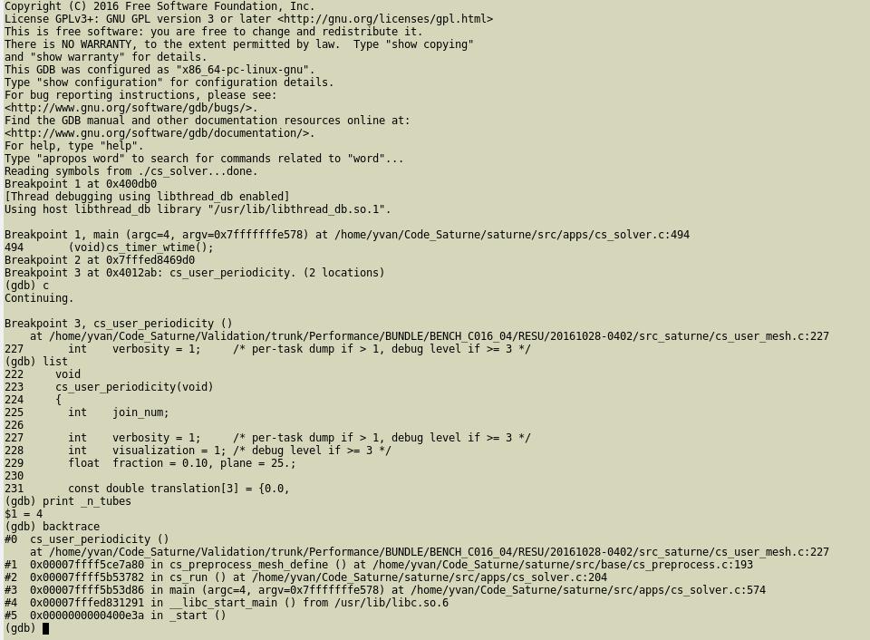

GDB basic interface
When used directly, GDB runs in a single terminal frame, as shown here. Only the current line of code is shown, though the list command allows showing more.

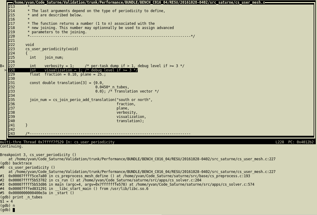

GDB in terminal mode
When started with the -tui option, GDB runs in a split terminal, with source on top, commands on bottom.
  • Using the CTRL+x+o key combination allows changing focus from one to the other.
  • Using the CTRL+l key allows refreshing the display.
GDB with split screen

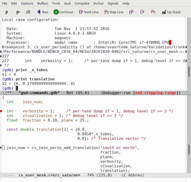

GDB may also be run under Emacs, which provides syntax highlighting of source code.
GDB under Emacs
GDB base commands
Checking the gdb documentation or tutorials is recommended. The most important gdb command is:
help
The most commonly used commands are:
  • b: set a breakpoint.
  • c: continue.
  • p: print a variable's value (using the current programming language syntax).
  • up: move up the stack.
  • down: move down the stack.
A running program may be paused using CTRL+C.
Variables may not only be printed, but also modified interactively, and functions may be called, making it easy to test some hypothesis without restarting the whole program.

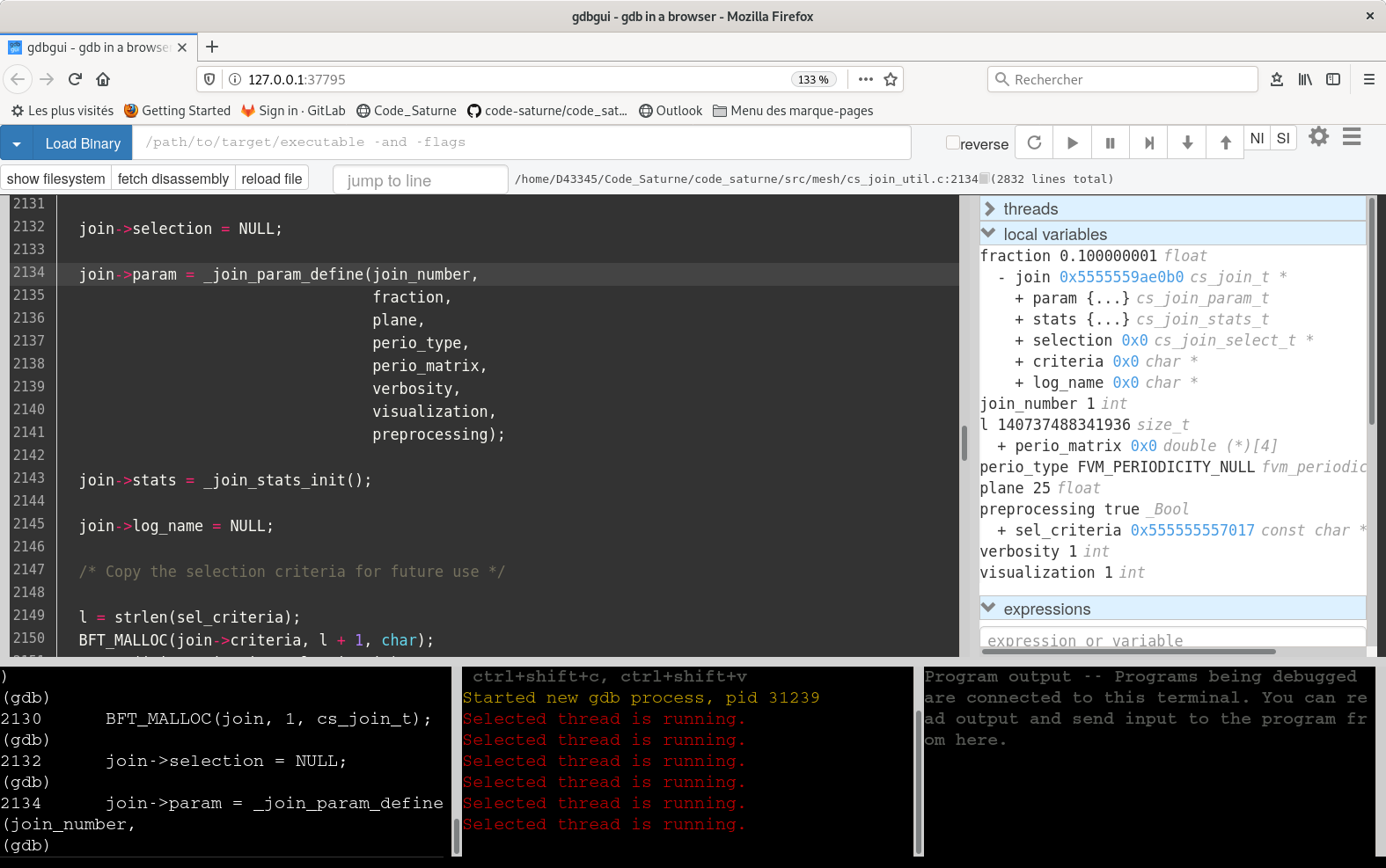

Graphical front-end recommendations
Many graphical front-ends are available for gdb. When evaluating a front-end, we recommend to check for the following features:
  • Must provide a console to allow combining text-based commands with the graphical elements, or at least easily-accessible widgets in which watchpoints and expressions to print can be typed.
  • Should allow some means (such as command-line options) to connect to a GDB server through a socket interface (more on this later)
The DDD (Data Display Debugger) front-end is obsolete and uses a dated graphical toolkit, but has the advantage of combining a command prompt with graphical tools, and is very easy to use, so it might remain an option.
The gdbgui debugger seems promising, and a good potential successor to DDD. It is based on a web-browser interface,
gdbgui

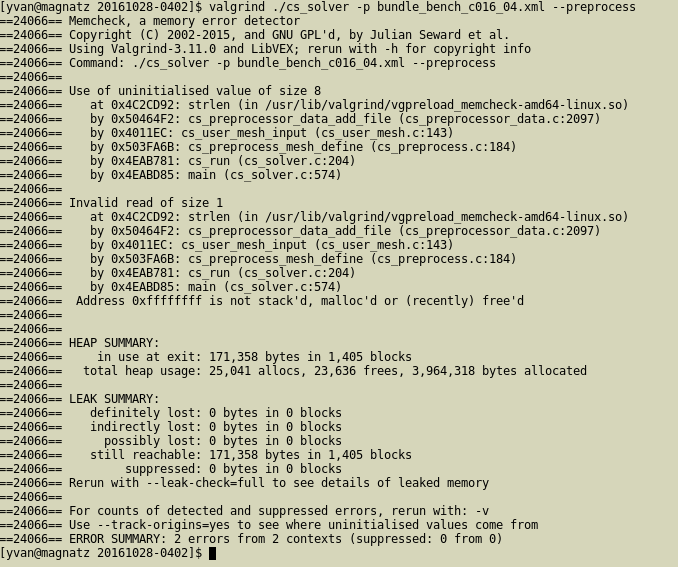

The Valgrind tool suite
The Valgrind tool suite allows the detection of many memory management (and other) bugs.
  • Dynamic instrumentation
    • No need for recompilation
      • Usable with any binary, but provides more info (i.e. code line numbers) with code compiled in debug mode
      • Depending on tool used, run time and memory overhead from 10-100x.
        • With default tool (Memcheck), 10x30.
        • Use proactively, to detect bugs on small cases, before they become a problem in production cases.
Valgrind is easy to run:
  • Prefix a standard command with valgrind
    • By default, uses the memcheck tool.
    • Tool may be changed using valgrind –tool=/cachegrind/callgrind/drd/massif/...
  • Valgrind may be combined with GDB using its gdbserver mode.
    • To use this mode, call valgrind –vgdb-error=<number>
      • The number represents the number of errors after which the gdbserver is invoked (0 to start immediately).

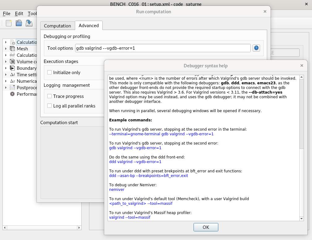

Starting the code_saturne solver under a debugger
Several ways of setting code_saturne to run under a debugger are possible:
  • Using the GUI, set options in Run computation/Advanced options`
    • The associated help provides several examples
    • This sets a debug_args option under the current resources section in the case's run.cfg file, which can also be edited directly.
  • The same options can be provided directly to code_saturne run using the --debug-args option
Example of use of debugger wrapper
When the code is run, the debugger will then be launched automatically.

Example commands:
To simply run using the gdb debugger:
gdb
To run Valgrind's gdb server, stopping at the second error in the terminal:
--terminal=gnome-terminal gdb valgrind --vgdb-error=1
To run Valgrind's gdb server, stopping at the second error:
Do do the same using the ddd front-end:
ddd valgrind --vgdb-error=1
To run under gdb with preset brekpoints at bft_error and exit functions:
gdb --asan-bp --breakpoints=bft_error,exit
To debug under gdbgui:
gdbgui
To run under Valgrind's default tool (Memcheck), with a user Valgrind build
<path_to_valgrind> --tool=massif
To run under Valgrind's Massif heap profiler:
valgrind --tool=massif

Running under Vim or Neovim
The code_saturne debug wrapper does not yet support launching GDB under Vim or Neovim.
Various examples of use of debugging with Vim are found on the web, explaining how Termdebug for example can be used.
Support for these tools could be added if users can provide a command-line example for launching a debugging session with their favorite editor and help test this.

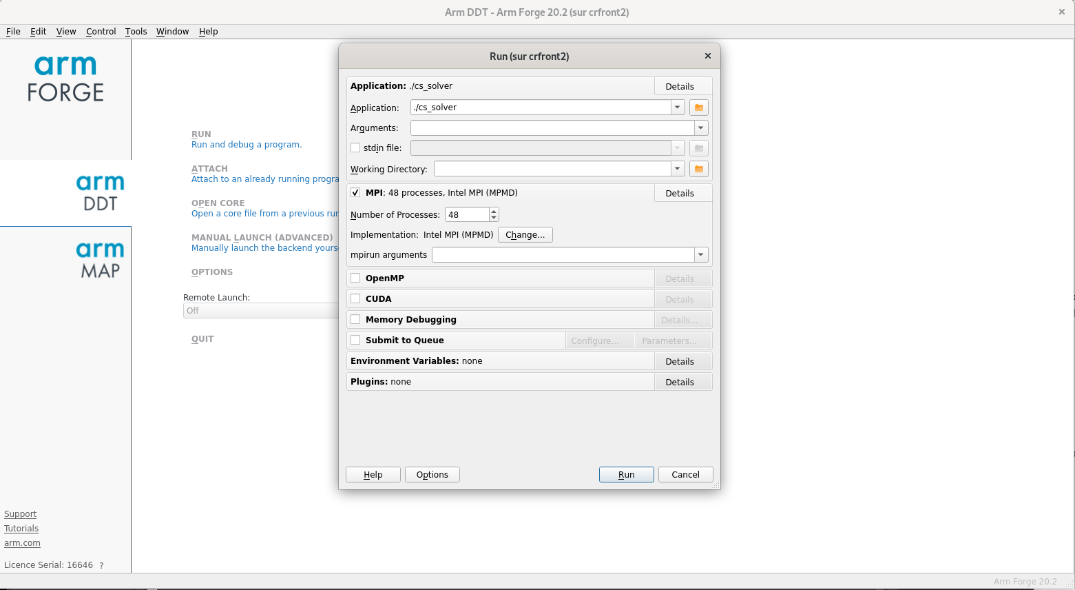

  • First, initialize the execution directory, using one of the following methods:
    • From the GUI, in the advanced run/job submission options, check "initialize only", then submit the computation.
    • Outside the GUI, run code_saturne submit --initialize In either case, the code will prepare the execution directory, and preprocess the mesh if needed, but not remove the executable and temporary script.:
  • Once the stage has finished, cd to the execution directory, and edit the run_solver script script:
    • Add commands necessary to load the debugger's environment. For example, on the EDF Cronos cluster, this requires adding
      module load arm-forge
      in the section where other modules are added.
    • Search for the line actually launching the solver, near the end of the script; before the cs_solver command, insert the debugger command. For example, for the DDT debugger, replace
      mpiexec <options> ./cs_solver
      with:
      mpiexec ddt <options> ./cs_solver
  • If using a batch system, request an interactive allocation (for example, using salloc with SLURM). ** This step is important: without this, you may be trying to run a large job on a front-end node, and your cluster administrators will not be happy.**
  • You can then run:
    ./run_solver
    which will launch the code under the interactive debugger.

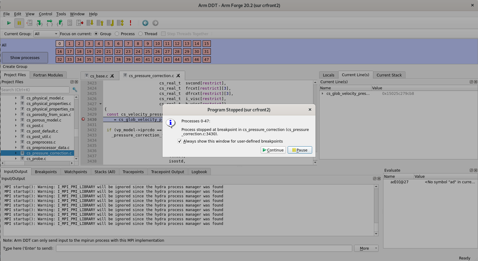

Debuggers such as DDT allows to easily switch between global and local stepping through the program and exploring its data, using a single window, as illustrated in this screenshot:
Global DDT pause

  • On some clusters using srun as the configured mpiexec command, the srun command configuration may not be compatible with DDT. In this case, switch to another appropriate mpiexec command.
  • In case launching the debugger fails, an alternative option is to simply replace the whole launch command (the line containing cs_solver) with the command launching the debugger's GUI, for example
    ddt
    And then simply follow the debugger prompts for command launch options, as shown in the example below.
    Example DDT launch options
