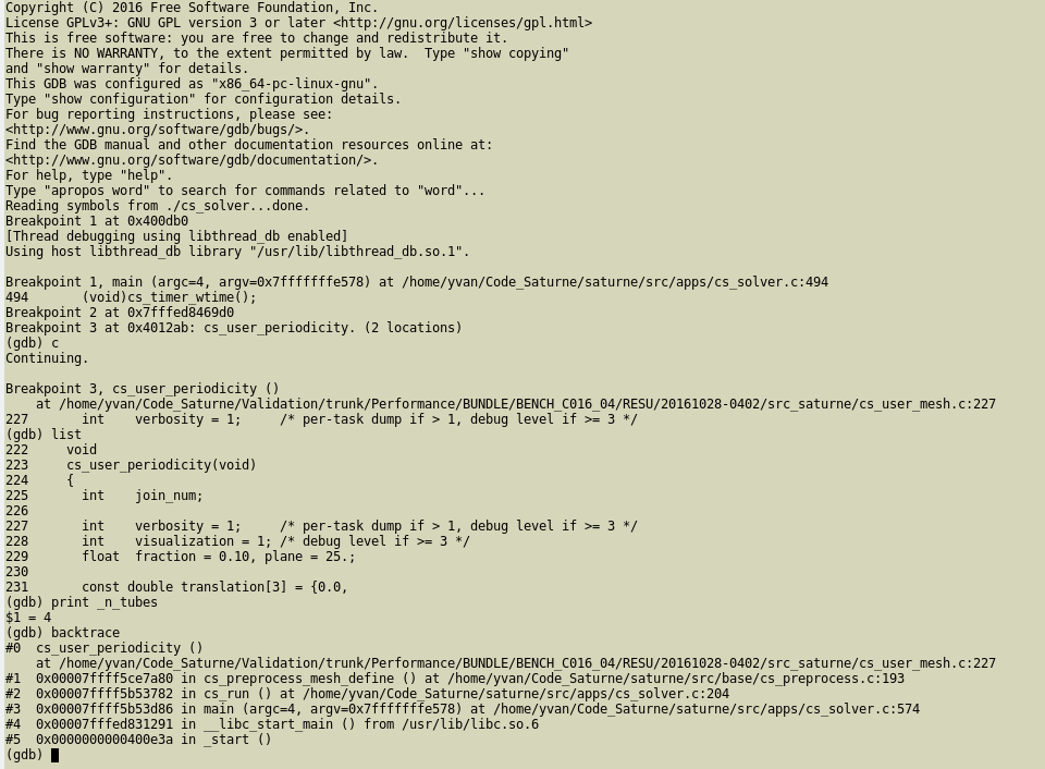

The GNU debugger https://www.gnu.org/software/gdb is a broadly available, interactive debugger for compiled languages including C, C++, and Fortran.
  • To debug an executable, run gdb <executable>
    • Under the gdb prompt, type help for built-in help, q to quit.
    • Help is grouped in categories
      • The most common options are:
        • b (set breakpoint),
        • c (continue to next statement),
        • s (step into function),
        • p (print).

GDB basic interface

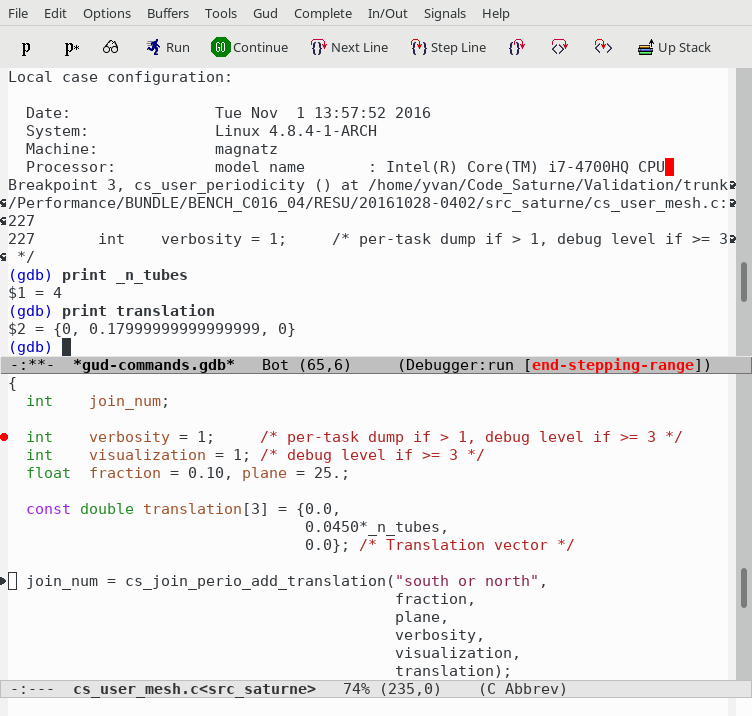

When used directly, GDB runs in a single terminal frame, as shown here. Only the current line of code is shown, though the list command allows showing more.

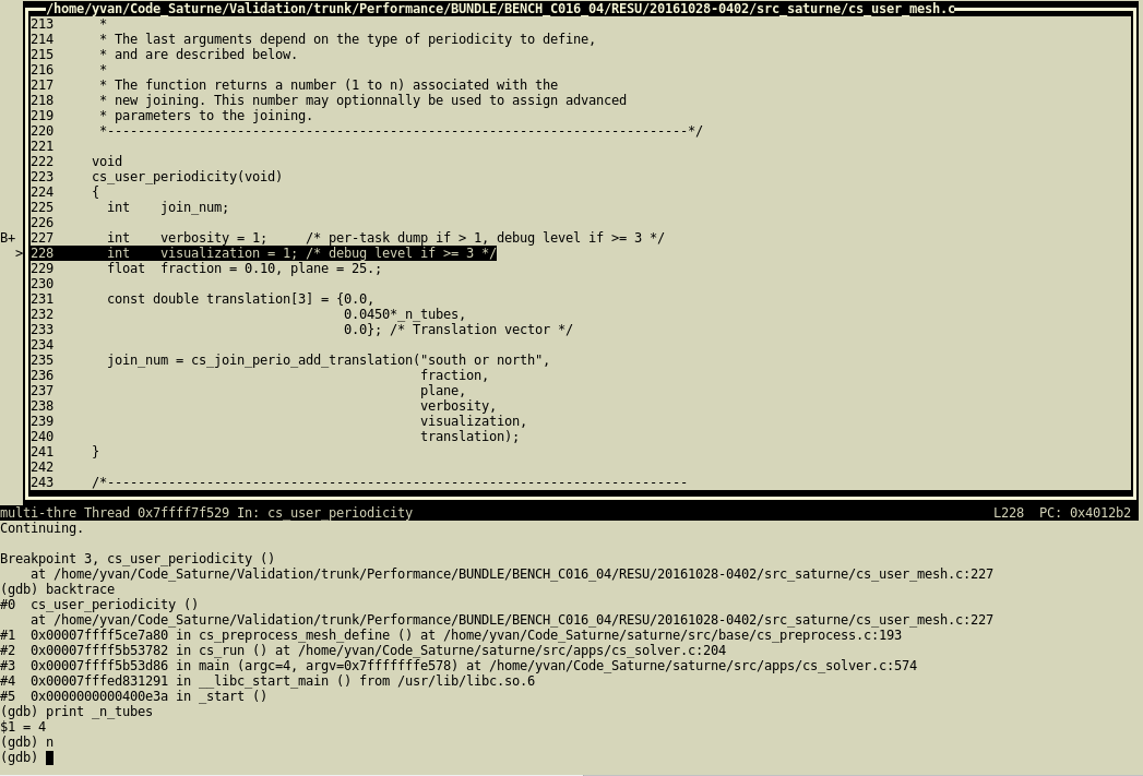

GDB in terminal mode
When started with the -tui option, GDB runs in a split terminal, with source on top, commands on bottom.
  • Using the CTRL+x+o key combination allows changing focus from one to the other.
  • Using the CTRL+l key allows refreshing the display.
GDB with split screen
GDB may also be run under Emacs, which provides syntax highlighting of source code.
GDB under Emacs

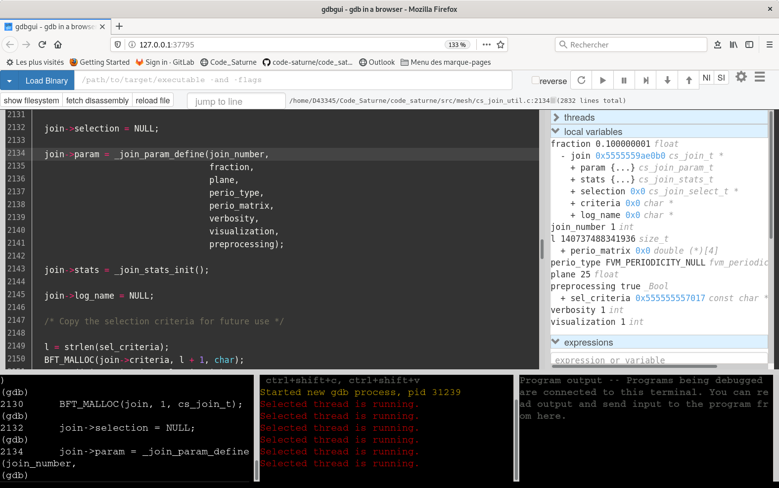

The DDD (Data Display Debugger) front-end is obsolete and uses a dated graphical toolkit, but has the advantage of combining a command prompt with graphical tools, and is very easy to use, so it might remain an option.
The gdbgui debugger seems promising, and a good potential successor to DDD. It is based on a web-browser interface,
gdbgui

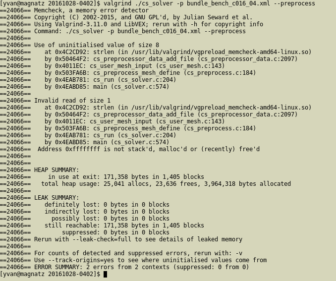

The Valgrind tool suite
The Valgrind tool suite allows the detection of many memory management (and other) bugs.
  • Dynamic instrumentation
    • No need for recompilation
      • Usable with any binary, but provides more info (i.e. code line numbers) with code compiled in debug mode
      • Depending on tool used, run time and memory overhead from 10-100x.
        • With default tool (Memcheck), 10x30.
        • Use proactively, to detect bugs on small cases, before they become a problem in production cases.
Valgrind is easy to run:
  • Prefix a standard command with valgrind
    • By default, uses the memcheck tool.
    • Tool may be changed using valgrind –tool=/cachegrind/callgrind/drd/massif/...
  • Valgrind may be combined with GDB using its gdbserver mode.
    • To use this mode, call valgrind –vgdb-error=<number>
      • The number represents the number of errors after which the gdbserver is invoked (0 to start immediately).
Valgrind in a terminal

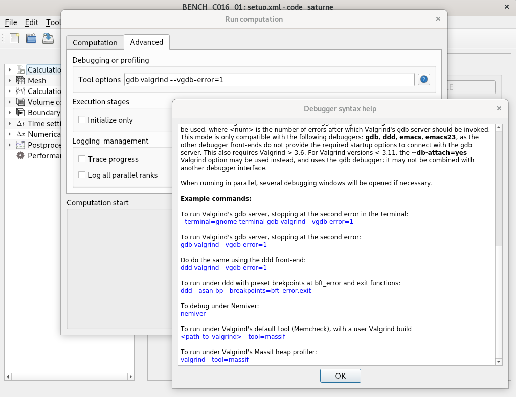

Starting the code_saturne solver under a debugger
Several ways of setting code_saturne to run under a debugger are possible:
  • Using the GUI, set options in Run computation/Advanced options`
    • The associated help provides several examples
    • This sets a debug_args option under the current resources section in the case's run.cfg file, which can also be edited directly.
  • The same options can be provided directly to code_saturne run using the --debug-args option
Example of use of debugger wrapper
When the code is run, the debugger will then be launched automatically.
Arguments required by the debug wrapper
To run the execution under a debugger, a string with the following syntax structure should be used:
<debugger> [debugger_options] [valgrind [[valgrind_options]]
Or, for Valgrind only:
<valgrind> [valgrind options]
where < > denote required arguments, and [ ] optional arguments.
