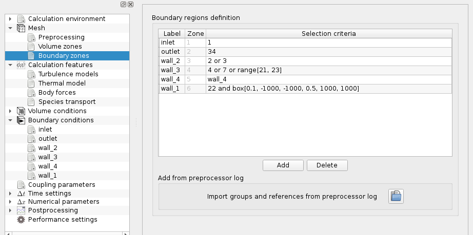

Prior to defining boundary conditions, the appropriate zones should be defined. Using the GUI, this is done in the Mesh section, as an early definition of the defined zones (before the mesh is actually read or built) may be useful for many other settings, not limited to boundary conditions.
In most cases, the names of mesh groups than can be used for zone definitions faces may be read directly from preprocessor.log file created by the Preprocessor. Following an initial mesh proprocessing or verification run, these definitions can be imported directly by the GUI under the "Mesh/Boundary zones/Add from Preprocessor log" section.

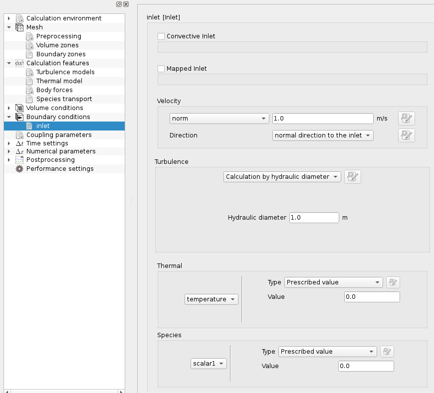

Based on the defined zones, the GUI can be used to define boundary types and conditions:
