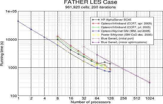

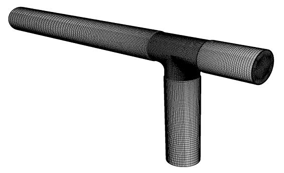

Example of “FATHER” LES case: thermal fatigue in a T-junction
- 1M of cells
- In 2003, a full run required 63 days using one vector processor on EDF's Fujitsu VPP 5000 computer for ten physical seconds simulated (50 000 iterations).
- In 2004, the same run required 10 days on 32 processors of an HP AlphaServer (CCRT)
- Now on Blue Gene EDF Machine: would require less than 1 day on 512 MPI ranks
